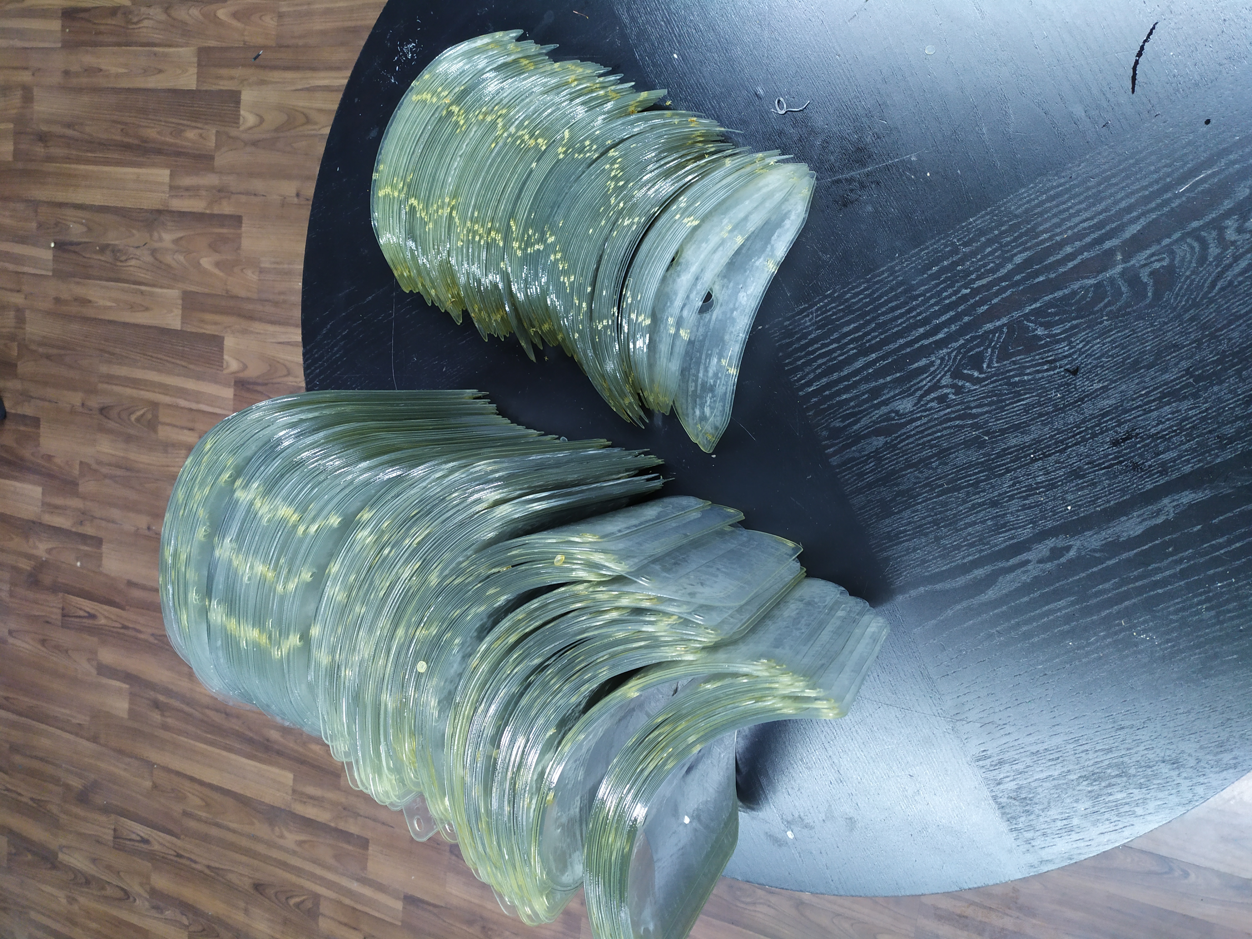

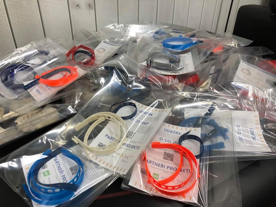

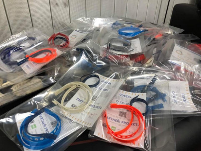

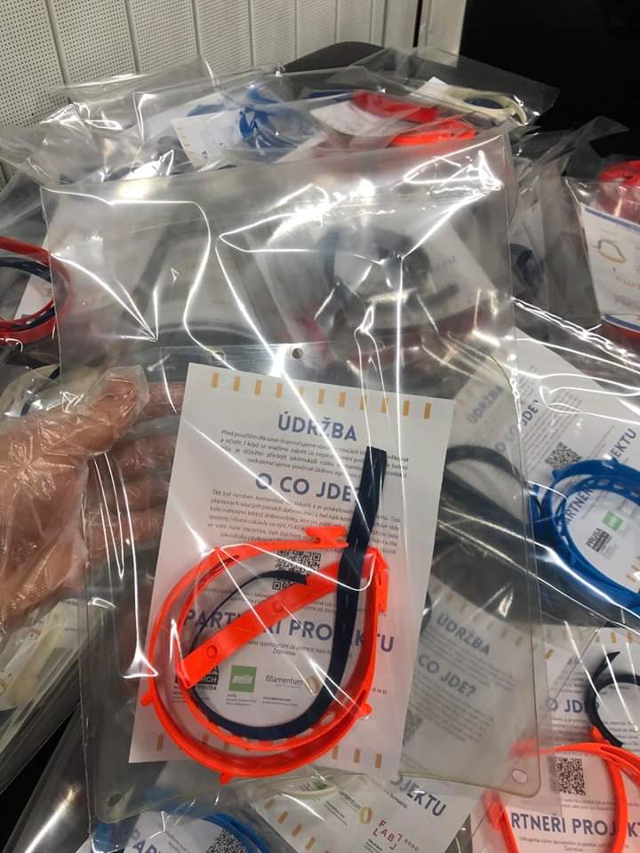

U nas probehla vyroba bryli a stitu pro nemocnice.

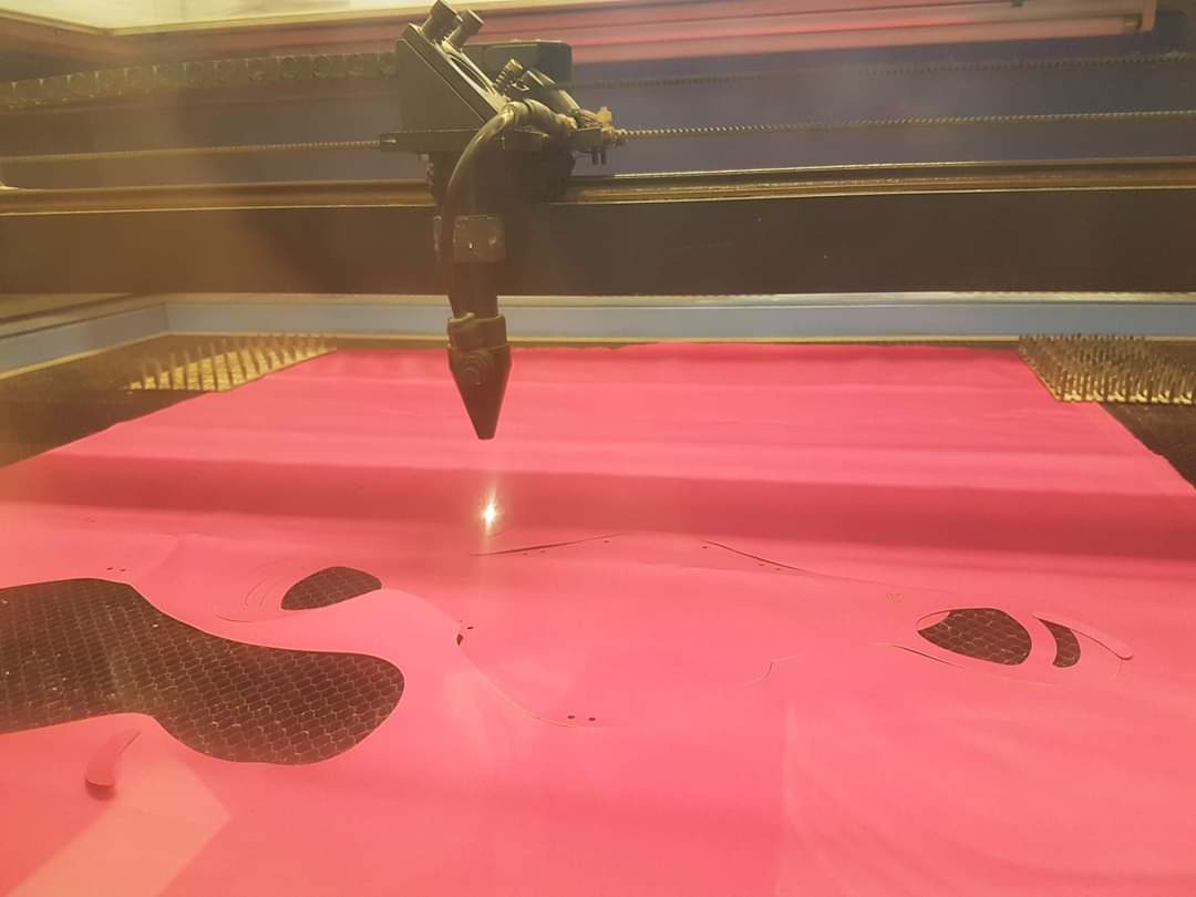

Kluci co mate laser
https://m.facebook.com/story.php?story_ ... 0355541226
Nastrihy latek na laseru pro rousky bez siti.
