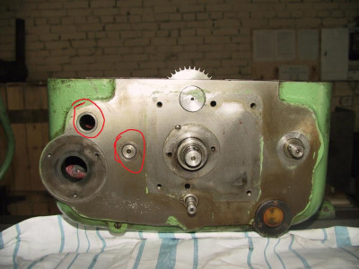

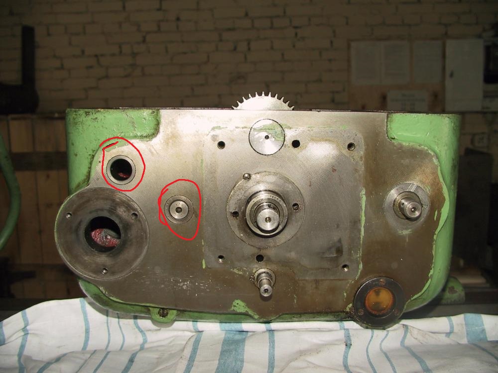

I left the workshop and forgot to measure the dimensions of the apron's bushings. And the material for their manufacture must already be ordered. I can't go back and measure now. Can anyone measure, at least approximately, the outer diameter of the bushings (circled in red, foto 1 and 2)?

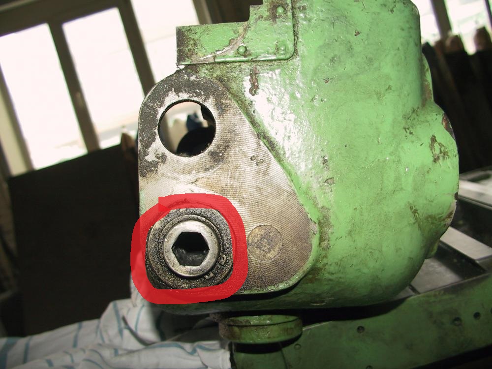

I also have a worn hex nut on the lead screw (foto 3). The inner edges are worn out and it looks more like a 12-sided one. Does anyone have blueprint for it? Or any ideas on how to fix it? If I make a new one, what is the best material? Cast iron, bronze, hardened steel?

Co kdybys to zkusil česky? Něco chceš a jsi na českém fóru,tak se snaž..
