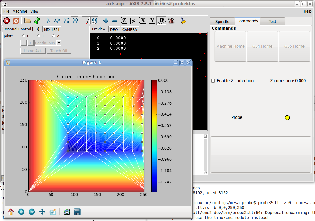

Takze vlastni zkusenosti:
upravil jsem si smartprobe.ngc z distribuce tak aby mi logoval absolutni souradnice masiny x,y
Kód: Vybrat vše
( This program repeatedly probes in a regular XY grid and writes the    )
( probed location to the file 'probe-results.ngc' in the same directory )
( as the .ini file                                                      )
( relative coordinates         #5061 #5062 #5063                        )
(Configuration section)
G21   (Milimeters)
F600    (probe speed)
#1=-20.	(X start)
#2=20.	(X increment)
#3=9.	(X count)
#4=-6.	(Y start)
#5=20.	(Y step)
#6=7.	(Y count)
#7=5. (Z safety)
#8=-5. (Z probe)
(End configuration section)
(LOGOPEN,probe-results.ngc)
#9=0 #10=0
G0Z#7
O1 while [#9 lt #6]
    #10=0
    G0 Y[#4+#5*#9]
    O2 while [#10 lt #3]
        O3 if [[#9/2] - fix[#9/2] eq 0]
            #11=[#1+#2*#10]
        O3 else
            #11=[#1+#2*[#3-#10-1]]
        O3 endif
        (#11 is X target)
        #5070=1
        O4 while [#5070 NE 0]
            G38.5 z#7
            G38.3 x#11
        O4 endwhile
        G38.2Z#8
	#501 = [#<_x>+#5221] ( to abs coords )
	#502 = [#<_y>+#5222] ( to abs coords )
        (LOG,#501 #502 #5063)
        #10=[#10+1]
    O2 endwhile
    G0Z#7
    #9=[#9+1]
O1 endwhile
(LOGCLOSE)
G0Z#7
G0X#1Y#4
M2
vystupem je probe-results.ngc
Kód: Vybrat vše
245.543521 191.858321 0.920191
225.543521 191.858321 1.248686
205.543521 191.858321 1.371344
185.543521 191.858321 1.439958
165.543521 191.858321 1.430386
145.543521 191.858321 1.500725
125.543521 191.858321 1.589677
105.543521 191.858321 1.630114
85.543521 191.858321 1.689988
85.543521 211.858321 1.750184
105.543521 211.858321 1.690089
125.543521 211.858321 1.600058
145.543521 211.858321 1.470142
165.543521 211.858321 1.370203
185.543521 211.858321 1.399980
205.543521 211.858321 1.370052
225.543521 211.858321 1.250084
245.543521 211.858321 0.860021
spachal jsem konvertor zero-probe.py ktery to posune k nule a otoci smysl Z
Kód: Vybrat vše
print('Zero set probing Z coordinate from probe-results.ngc to zero-probe-results.ngc')
data = []
smallest = 1000
with open('probe-results.ngc') as f:
    for line in f:
        axes = line.split()
        data.append(axes)
        if smallest > float(axes[2]):
            smallest = float(axes[2])
print('Smallest value: ' + "{0:6f}".format(smallest))
with open('zero-probe-results.ngc', 'w') as f:
    for line in data:
        f.write(line[0] + ' ' + line[1] + ' ' + "{0:6f}".format(-1* (float(line[2])-smallest)) + '\n')
print('Done')
vysledkem je zero-probe-results.ngc
Kód: Vybrat vše
245.543521 191.858321 -0.060170
225.543521 191.858321 -0.388665
205.543521 191.858321 -0.511323
185.543521 191.858321 -0.579937
165.543521 191.858321 -0.570365
145.543521 191.858321 -0.640704
125.543521 191.858321 -0.729656
105.543521 191.858321 -0.770093
85.543521 191.858321 -0.829967
85.543521 211.858321 -0.890163
105.543521 211.858321 -0.830068
125.543521 211.858321 -0.740037
145.543521 211.858321 -0.610121
165.543521 211.858321 -0.510182
185.543521 211.858321 -0.539959
205.543521 211.858321 -0.510031
225.543521 211.858321 -0.390063
245.543521 211.858321 -0.000000
nacteni do linuxcnc
Kód: Vybrat vše
mc@emc-desktop:~/linuxcnc/configs/mesa_probe$ probe2stl -z 1 -i mesa.ini <zero-probe-results.ngc |stlcorr --load -d
pouzil jsem i konfiguracni soubor masiny - probe2stl si natahne jeji rozjezdy a vygeneruje kompenzaci tak aby se z ni nevyjelo.
+ vizualizace
Kód: Vybrat vše
emc@emc-desktop:~/linuxcnc/configs/mesa_probe$ probe2stl -z 0 -i mesa.ini <zero-probe-results.ngc | stlvis -b 0,0,250,250
+ jsem si probekins zkompiloval s verzi 2.5 a udelal do gladevcp bocni panel pro ovladani.
a cela ta saskarna jenom kvuli tomu ze nedokazu upnout hlinikovy plech rovne a vzdy se mi prohne.

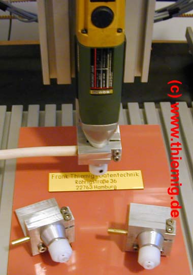

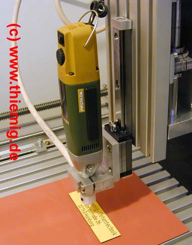

Možná je to off-topic, protože se jedná o odlišný způsob vypořádání se zvlněním cuprextitu (povrchu) ale já používám způsob mechanický, nikoliv softvérový.
Kdysi jsem si koupil tzv. tiefenregler (regulátor hloubky) a haftgravurmatte (lepivá gumová podložka). viz zde: http://www.thiemig.de/" onclick="window.open(this.href);return false;
Ten regulátor hloubky se dá použít pro vřetýnka Proxxon (na plošňáky stačí) a slouží k upnutí vřetena. Šroubovacím "nosem" se nastaví míra vykouknutí špičky nástroje (třeba 0,2mm) a dále se na něj dá připojit odsávání, což je v případě gravírování sklolaminátu nezbytnost (jinak drobné částice skelných vláken mohou způsobit silikózu resp rakovinu). Gumová podložka je z obou stran lepkavá, takže desku cuprextitu pevně drží a přitom pod pevně dotlačeným kluzným "nosem" tiefenregleru malinko uhne (dolů). Takže stačí s osou Z najet do záběru pár setin víc než je okamžik dotyku kluzného nosu s mědí cuprextitu a dá se krásně frézovat s konstantní stopu nástroje.
Gumová podložka je dále výhodná při vrtání plošňáku, protože vrták nejde do tvrdého materiálu. Sice se navrtáním mírně poškodí ale i po několika desítkách zhotovených spojů pořád dobře drží. Při zaprášení frézovaným materiálem se dá opláchnout vodou a lepivost se obnoví.
Zkrátka, řečeno slovy klasika: "Jak primitivní, leč jak účinné!"
Na obrázku je dále vidět použití kousku lineárního vedení na ose Z, umožňujícího vřetenu volně plout a přitlačovat se do záběru vlastní vahou vřetene. Já toto nepoužívám, prostě ten tiefenregler naperu pár setin proti gumě (přes plošňák) a hotovo.
