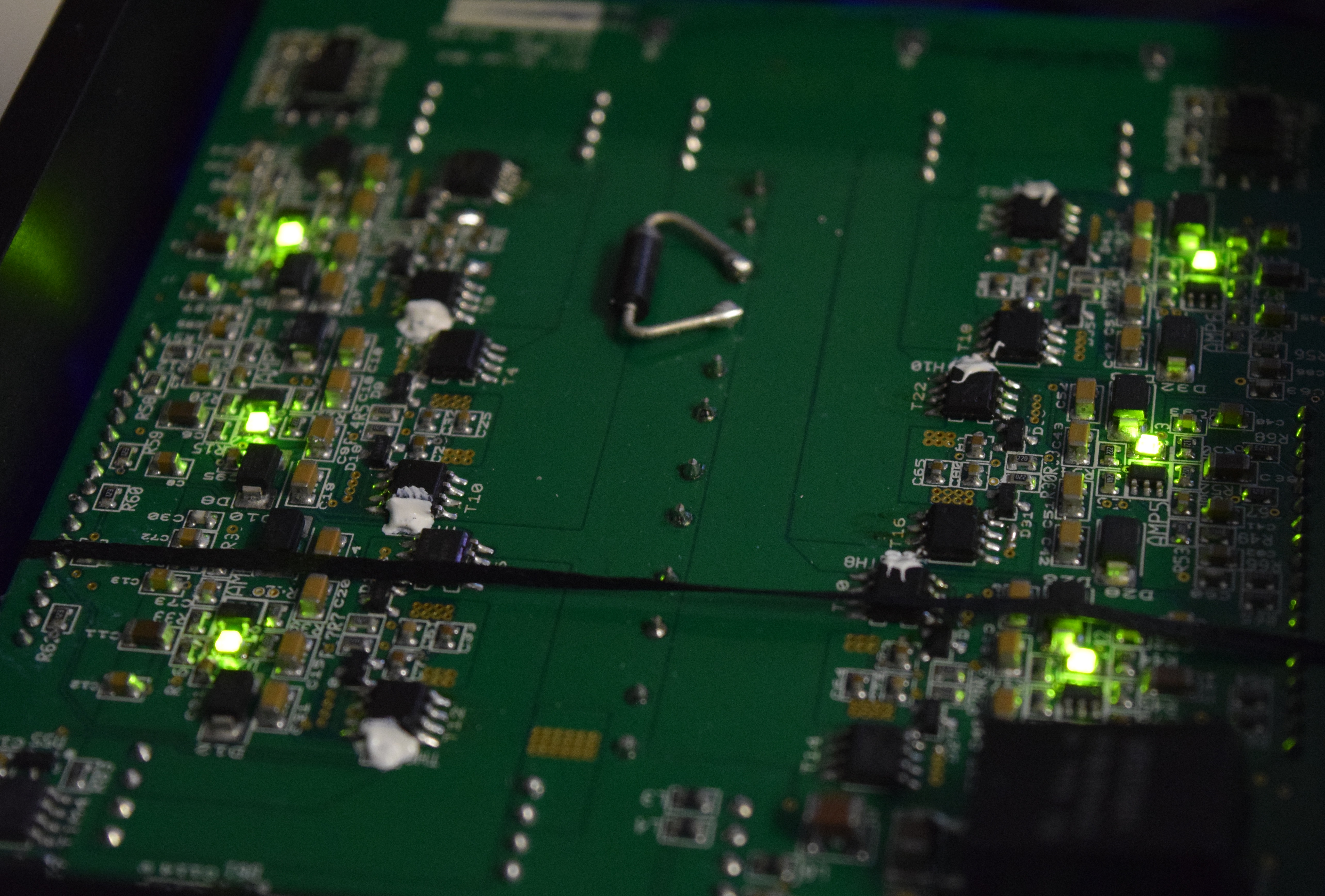

That sounds interesting! But isn't it easier to put an ethernet module directly to each inverter and eliminate the need for breakout board? If you have closed network, the timing is pretty good. And if you want something really precise, you can send the data to all nodes and then broadcast a trigger packet to all nodes at once to keep them in sync.
3Ph inverter, input AC 230V, max 2kW
6-ch DC motor controller, 80V, 15A/Ch
