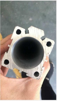

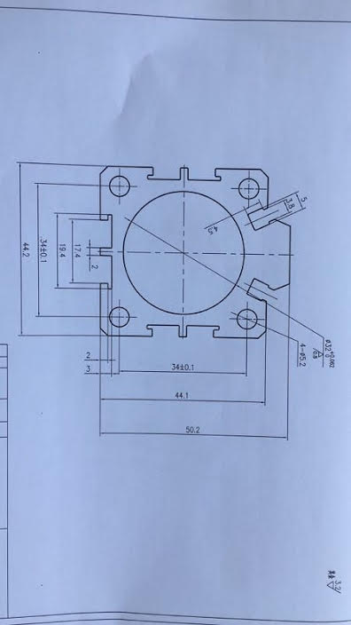

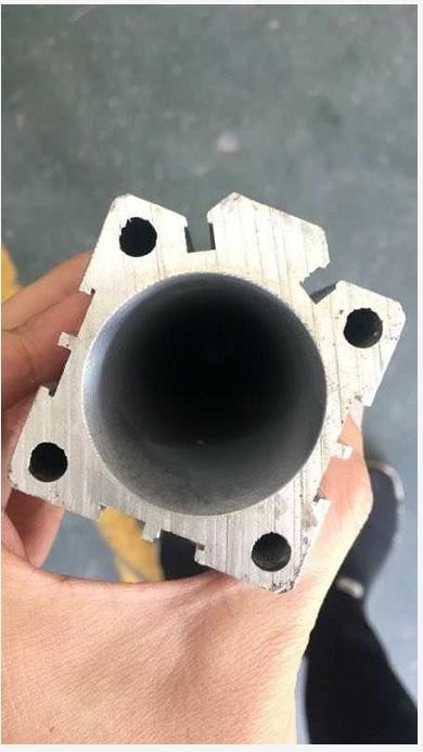

Vie mi niekto prepravit tento balik az domov alebo staci aj po Bratislavu za rozumnu cenu?
Vo vnutri su taketo profily(foto)
The package size is about 2.08m*0.22m*0.14m, the weight is about 55KG.
Waiting for your kindly responds.
My best regards.
Yours Sincerely Cora
