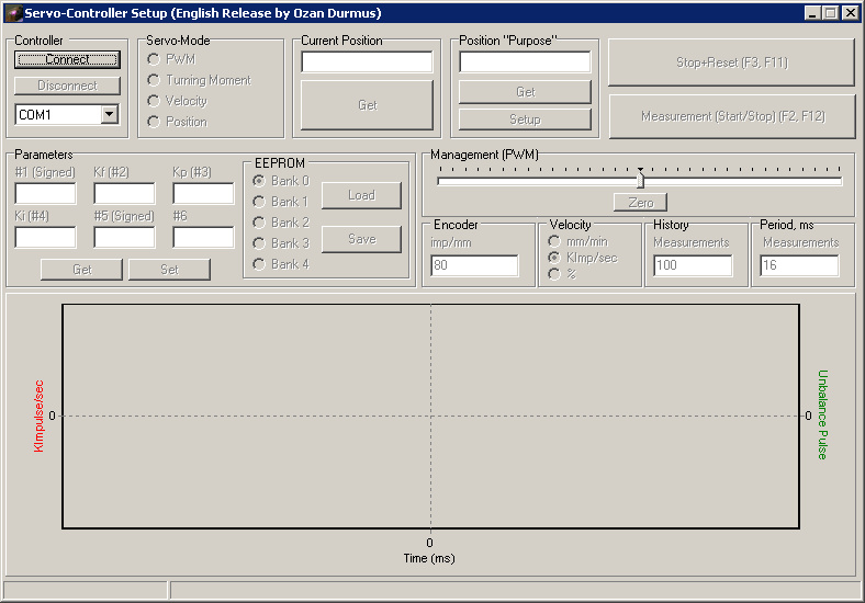

Dear Friends,
Here's the English Release of ServoTuning.exe , i did it without permission from author since there's no reply from him. But i hope this helps many people who want to try, since i did not build up board i'm not sure if there's else translation exists in dialogs.
It will be perfect if another friend share an english documentation for :
* Latest HEX (EEP file too in some cases) and Fuse Settings
* PCB and Layout (Various AVR Processors)
* ServoTuning software guide
Best Regards,
Ozan
ServoTuning-English.zip
(296.19 KiB) Staženo 1225 x

Thank you for the translation ServoTuning.exe
Even a small correction.
http://www.cnczone.com/forums/showpost. ... stcount=58
