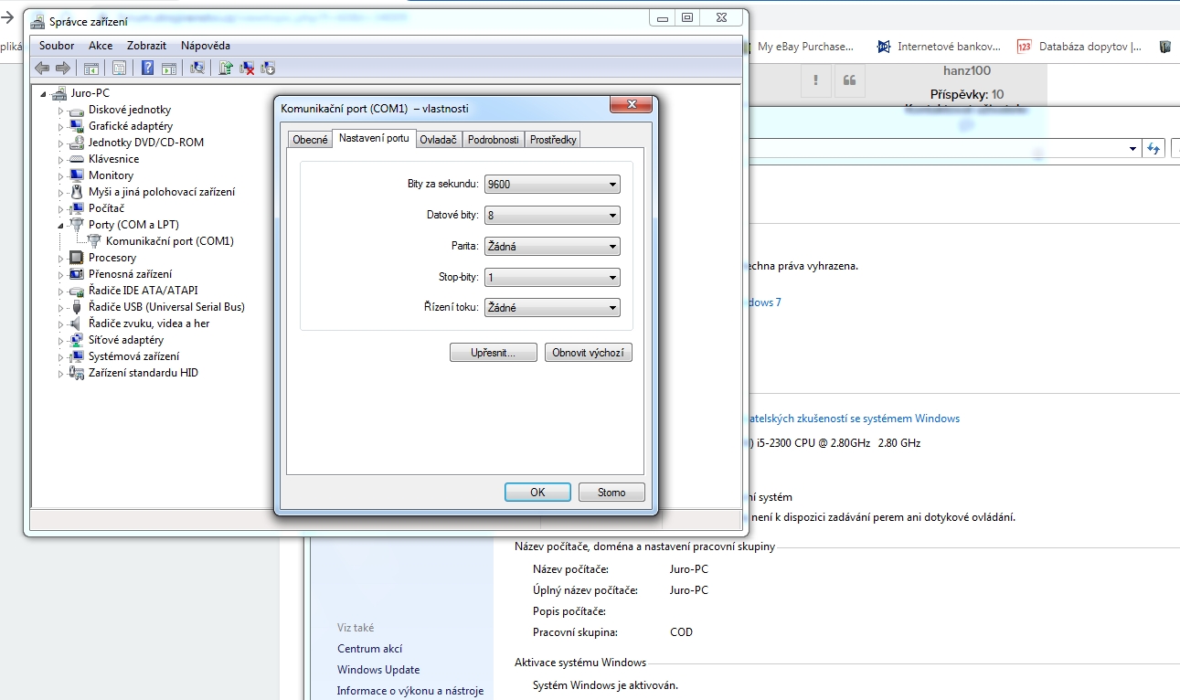

Toto v pocitaci mas spravne nastavene?

jo mam koukal sem na to nastaveni a menil podle navodu co je pdf vubec nic me to nedela

Ja vim zes to urcite kontroloval, ale nejcasteji za to muze kabel. Tady musi byt plne obsazeny, propiskej pin po pinu multimetrem.

13.1.2 Configuring the Port for the NUMCOM Software
NUMCOM is a public domain programme relatively widespread among NUM CNC users. It runs under DOS. It is used
to upload and download files via a serial interface. Other applications, such as NUMPC, are available from the NUM
network.
In order for NUMCOM to operate correctly, set the port as follows:
Line Number Free choice; see Sec. 13.1.
Standard RS232
Input Speed (Bds) 9600
Output Speed (Bds) 9600
Number of start bits 1
Number of data bits 8
Number of stop bits 1
Parity None
Protocol None
Flow Control RTS/CTS
Logical Name Free choice, but COMM1 is recommended
Configuration x/12 Accept
